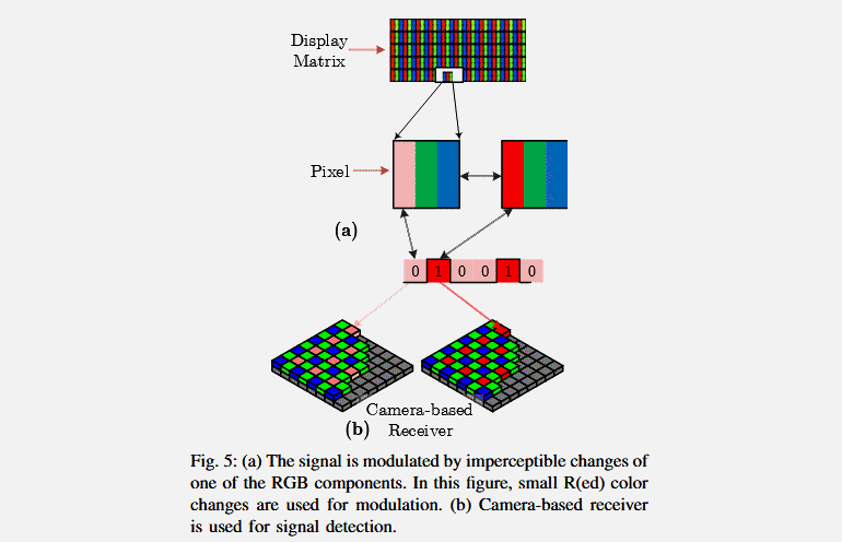

3. Malware alters a screen’s color settings to modify the brightness level.
4. The brightness level is adjusted up/down in order to relay a 0/1 binary pattern that transmits a file, one bit at a time.
5. A nearby attack records the screen of the infected computer.
6. The video is analyzed and the file is reconstructed by analyzing the variations in the screen’s brightness.
The research team said it tested the BRIGHTNESS attack in several configurations. Researchers say they had the best results by modifying the Red color pixels with around 3% from their normal settings.
 ![image](https://onehack.st/uploads/default/original/3X/e/f/efe6f472a81f6bd4248f1363fe443430d49476e5.png)
Image: Ben-Gurion University of the Negev, Israel
This small change is invisible to the human eye due to the high refresh rates on modern LCD screens, but can be picked up by modern high-resolution video cameras that often come with webcams, smartphones, laptops, or security camera equipment.

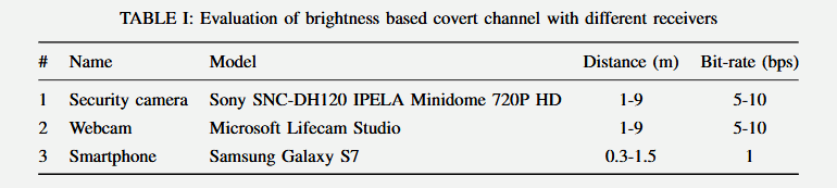

However, transmitting data this way is extremely slow. Researchers reported maximum speeds of 5-10 bits/second, which is an incredibly low transmission speed – among the lowest of all the air-gap exfiltration attacks listed earlier in this article.
 ![image](https://onehack.st/uploads/default/original/3X/6/8/6898744f3459370e3da1efca15a3c174889ea3e0.png)
This speed means the attack might be useful for stealing a small encryption key but don’t hold your breath for exfiltrating a 1GB ZIP archive without the risk of getting detected.
