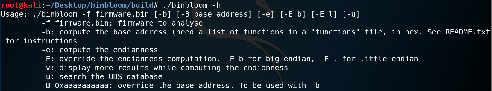

![image](https://onehack.st/uploads/default/original/3X/6/a/6a9743f3f124dbcadfea1f517795d9224d0a0124.jpeg)
The purpose of this project is to analyse a raw binary firmware and determine automatically some of its features. This tool is compatible with all architectures as basically, it just does simple statistics on it.
In order to compute the loading address, you will need the help of an external reverse engineering tool to extract a list of potential functions, before using binbloom.
Main features:
- **Loading address** : binbloom can parse a raw binary firmware and determine its loading address.
- **Endianness** : binbloom can use heuristics to determine the endianness of a firmware.
- **UDS Database** : binbloom can parse a raw binary firmware and check if it contains an array containing UDS command IDs.
