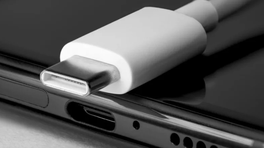

USB4 cables will use Type-C connectors, which is the flat, rounded port found on most [smartphones and laptops these days](https://lifehacker.com/are-you-charging-your-macbook-on-the-wrong-side-1843045306).
You should be able to plug a USB4 cable into just about any USB Type-C port, but it won’t always function the same way. For example, a USB4 cable will experience a drop in speed when plugged into an older port, while older USB Type-C cables plugged in USB4B 4.0 port will use their highest-possible transfer speed by default (but can’t reach the same speeds as a USB4 cable).
Similarly, you may need and an adapter to use USB4 cables with USB Type-A ports, which the kind you usually see on PCs.
