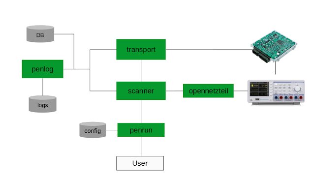

Gallia is an extendable pentesting framework with the focus on the automotive domain. The scope of the toolchain is conducting penetration tests from a single ECU up to whole cars. Currently, the main focus lies on the [UDS](https://www.iso.org/standard/72439.html) interface. Taking advantage of this modular design, the [logging and archiving](https://fraunhofer-aisec.github.io/gallia/penlog.7.html) functionality was developed separately. Acting as a generic interface, the logging functionality implements reproducible tests and enables post-processing tasks. The [rendered documentation](https://fraunhofer-aisec.github.io/gallia) is available via Github Pages.
