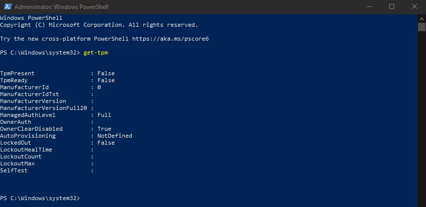

The easiest way to check if you have a TPM chip is to run the **get-tpm** command via Windows PowerShell.
To do this, type PowerShell in the Start menu search bar. **Right-click** on the Windows PowerShell result and choose **Run as administrator**. Click **Yes** on the confirmation window.
In the Windows PowerShell app, type **get-tpm** , then press **Enter**. You should see the following result:
If **TpmPresent** returns False, then, unfortunately, your motherboard doesn’t have a TPM chip. But if you get the following results:
- **TpmPresent** : True
- **TpmReady** : False
You can then activate the TPM chip in your BIOS/UEFI and check if you’re eligible for the Windows 11 upgrade. That is, assuming the rest of your system is up to scratch with the Windows 11 upgrade requirements.

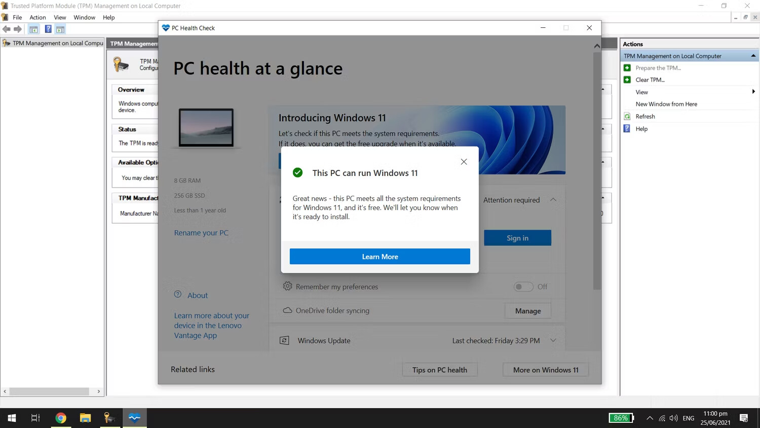

Microsoft initially announced that users would require TPM 2.0 to run Windows 11. However, they later revised their [documentation](https://docs.microsoft.com/en-us/windows/compatibility/windows-11/), setting a minimum requirement of TPM 1.2, with TPM 2.0 being a recommended version.
Now, if you attempt to upgrade to Windows 11 with a TPM 1.2 chip but not a TPM 2.0, you’ll encounter a message stating that the “upgrade is not advised.” But if you don’t even have a TPM 1.2 chip, you won’t even make it that far—the Windows 11 upgrade won’t be offered to your device.

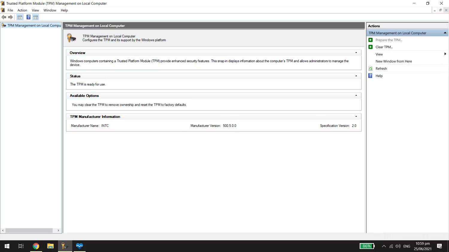

Now that you know whether you have a TPM chip installed or not, check your TPM version. Press **Windows key + R** , then type, **tpm.msc**. The Trusted Platform Module (TPM) Management window should open.
Under the **TPM Manufacturer Information** subwindow, look for the **Specification Version**. You should see what TPM version your PC is running under there.
