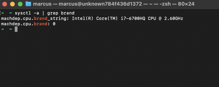

On Mac, enter **sysctl -a | grep brand** into your terminal. To find your CPU’s socket type, search “[yourCPU] + socket type.”

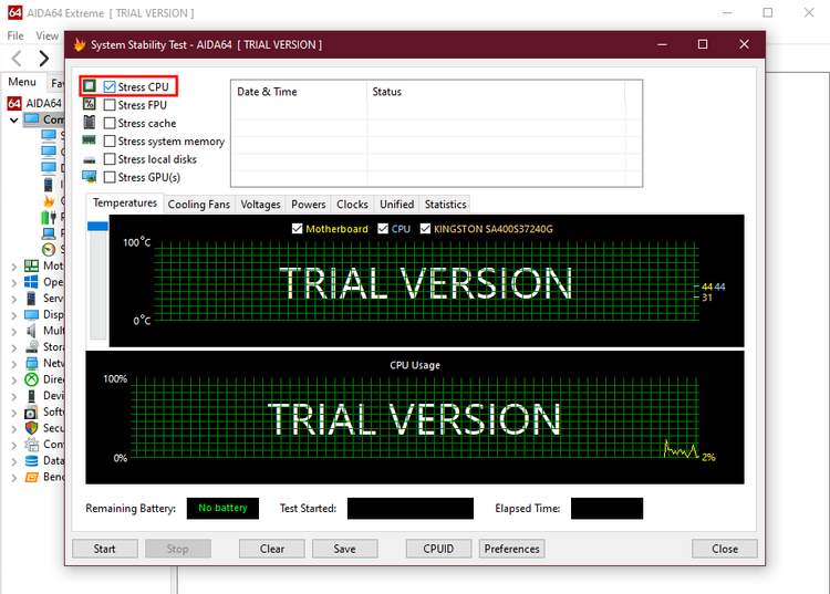

We’ll be using [Aida64 Extreme to stress test our CPU](https://www.aida64.com/downloads) in this example (it costs $34.99 a month, but you can use a 30-day free trial to fulfill your overclocking needs), though there are plenty of free apps available that do the same thing.
Here’s how to run a CPU stress test using Aida64 Extreme:
1. Launch **Aida64 Extreme**.
2. Click the graph icon which reads **System Stability Test** when you hover over it.
3. In the top left, untick all options other than **Stress CPU**.
4. Click **Start** at the bottom left. Let Aida64 run the tests, then press **Stop**.
5. Monitor the results on the **Statistics tab** and **Save** them if you wish.

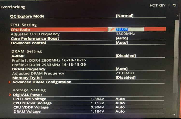

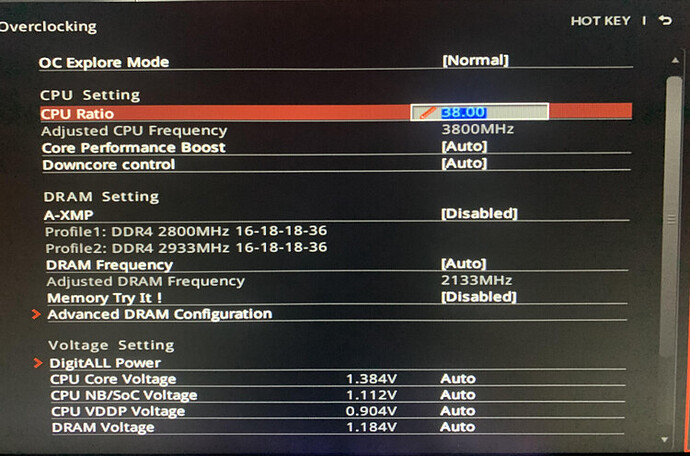

First, let’s adjust the CPU multiplier (or **CPU Ratio** ).
This affects your PC’s base internal clock speed (usually set at 100MHz); multiply this internal clock speed by the CPU multiplier to measure overall clock speed (100 x 38 = 3.8GHz).
 ![image](https://onehack.st/uploads/default/original/3X/3/c/3cd1afe697d95d01df9a740790b49e5a10830c62.jpeg)
Raise this multiplier in small iterations. The higher you raise it, the hotter your machine will become, causing instability and possible damage to the parts at extreme temperatures.
After raising one core’s speed, you can attempt to raise other cores as well. The more core multipliers you raise, the more heat your machine will produce. In this, you must be meticulous with only raising the multiplier in very small increments and testing your system between increases for heat generation and stability.
Save the new settings and restart your PC. Run another benchmark to check CPU performance and stability, then head to the next section.
