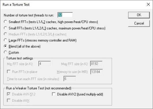

When the program starts in stress testing mode, you get to make a few choices regarding the specific punishment.
 ![image](https://onehack.st/uploads/default/original/3X/e/8/e8f324c136d29c02e397d3bf2298877906105475.png)
The “blend” option is best for general system testing, but as you can see some of the other options target specific components. So if you want to focus on RAM, for example, you can.
The number of threads will be filled in automatically, but it should be equal to the number of cores in your system or double that amount if your CPU features HyperThreading. Since our computer here has six cores with HyperThreading, we need 12 “workers” as they’re referred to in the app. Once you’re happy with these settings, just press OK and you should see this.

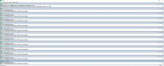

 ![image](https://onehack.st/uploads/default/original/3X/1/c/1c92c2b2496afa4ddf0d90e87ed7336cbdaf2c80.png)
Your computer is now running the CPU at full throttle and you’ll hear the fans spin up momentarily to deal with the extra heat. Once you’ve run the CPU stress test for your desired time period (and there were no errors) you can press **Test** \> **Stop** to give your poor CPU a break.

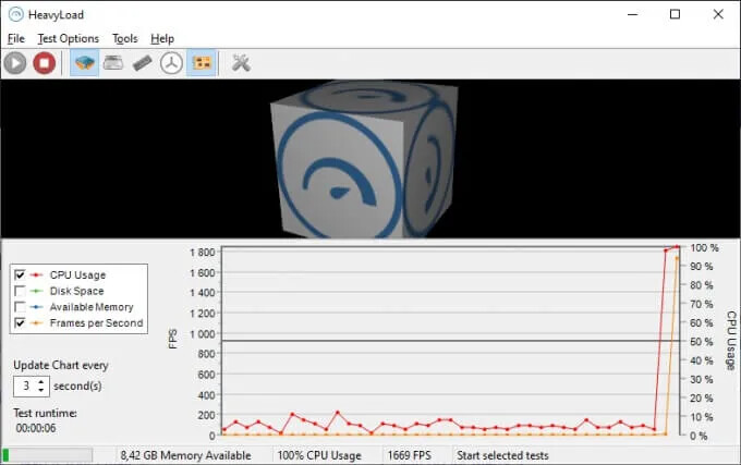

Unlike Prime95, HeavyLoad isn’t a repurposed scientific tool. Instead it’s an app that was built from the ground up to stress test computers. One of the best things about this program is that you can choose to stress your GPU and CPU at the same time. This is important if you want to check total system stability and are planning to use the computer for tasks that are heavy on both types of processor.
You can toggle which components should be stressed with the handy buttons on the toolbar. If you’re good with the default CPU+GPU option, just press the play button and the torture will commence.
 ![image](https://onehack.st/uploads/default/original/3X/9/e/9e412b429ed6498607a8b59f19d50189c3d7acb8.jpeg)
HeavyLoad doesn’t create the sort of deathly heat in a CPU that Prime95 does, but it does represent a more realistic maximum load. Prime95 is the gold standard for torture testing, but few it any real-world software is going to hit your CPU right in the math with so much force. If it survives a HeavyLoad session, then it’s probably going to be fine for something like a video game.

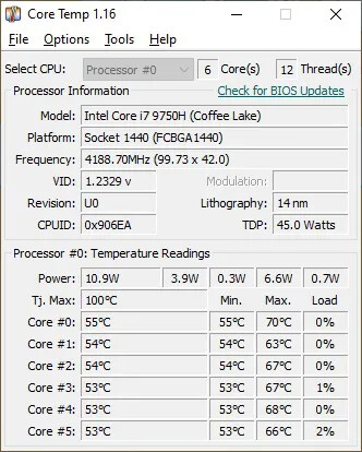

One of the key reasons to do a stress test is to see if your CPU is overheating or not. CoreTemp is a well-respected tool that provides you with crucial information about your hardware. For example, it shows you the real-time clock speed of your CPU as well as its technical data.
 ![image](https://onehack.st/uploads/default/original/3X/e/e/ee4ba34ac8bca524e6237a527a4561679e7d8691.jpeg)
Of course, the main reason to use CoreTemp is the live temperature readout. Each one of your CPU cores get their own individual temperature monitors. When you run a stress test, you’ll see those temperatures climb. If your CPU reaches its maximum rated temperature, it will either throttle it’s speed to reduce heat or for the system to shut down as a means of protection.
In CoreTemp you can see all of this happen in real time, which is invaluable if you want to know whether unstable voltage, throttling or excessive heat is responsible for bad CPU behavior.
