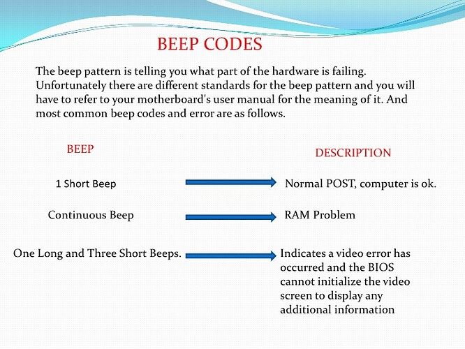

![computer-hardware-troubleshooting-7-728](https://onehack.st/uploads/default/original/2X/7/7d8c67b95fcf3d77dc3f7731529508fda67976a3.jpg)
Beep Code Manual, Better Than Gold Techies, American Megatrends Int. & Phoenix
(I’m IT, I use these codes to trouble shoot hardware issues at my job. Enjoy) 🕶
BIOS Beep Codes
When a computer is first turned on, or rebooted, its BIOS performs a power-on self test (POST) to test the system’s hardware, checking to make sure that all of the system’s hardware components are working properly. Under normal circumstances, the POST will display an error message; however, if the BIOS detects an error before it can access the video card, or if there is a problem with the video card, it will produce a series of beeps, and the pattern of the beeps indicates what kind of problem the BIOS has detected.
Because there are many brands of BIOS, there are no standard beep codes for every BIOS.
The two most-used brands are AMI (American Megatrends International) and Phoenix.
Below are listed the beep codes for AMI systems, and here are the beep codes for Phoenix systems.
