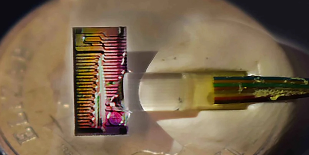

The researchers and engineers at Monash University, Swinburne, and the Royal Institute of Technology in Melbourne, Australia, have developed a chip that could one day become a part of our internet infrastructure and will be able to offer millions of users, extremely high-speed internet connections, even during the bad situations and national emergencies as well.
The researchers have clearly stated that they have successfully tested their small optical device to achieve a total speed of 44.2 Terabits per second (Tbps), which is the highest internet speed recorded from a single light source.

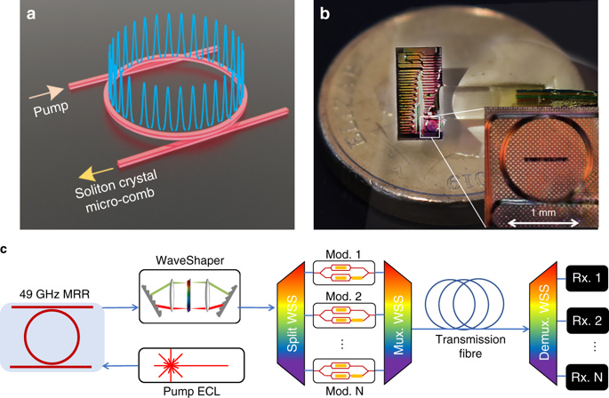

Here, the researchers have used the ‘comb of optical frequencies,’ instead of fiber optic cable, and they have named this as “Micro-combs.” Though, this technology is not exactly something new, as the concept has been around for a decade. But with the increasing pressure on our data centers, it has been showing its potential to miniaturize and boost the technologies behind the internet connections.
“Moreover, these ‘Micro-combs’ have become a center of attraction for the researchers from several fields, since they were discovered,” said, David Moss, the Director of the Center for Optical Sciences at the Swinburne University of Technology.
The Micro-combs are optical frequency combs that are based on micro-cavity resonators, and they have shown notable promise in accomplishing the current requirements. In short, according to the researchers, an important benefit of this chip is the ability to make the most of the existing infrastructure to meet the demand expected in the coming years.

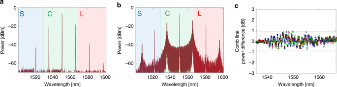

By using the large modulation format of 64 QAM (quadrature amplitude modulation), a low comb-free spectral range (FSR) spacing of 48.9 GHz, and the telecommunications C-band, the researchers have managed to achieve these results.
Moreover, the Australian researchers have stated that they have used this ‘Micro-comb’ to replace 80 different lasers for a single crystal waveform generator, which is minor and lighter than the existing devices.

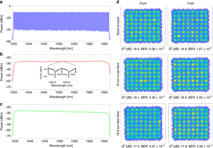

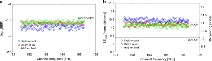

As from the below graph, you can see three types of circle points, blue, red, and green; this graph will show you the bit-error ratio, spectral efficiency, and GMI (Generalised Mutual Information) for transmission experiment.
Here, the blue points show the performance of the channels in a B2B configuration, while the red points show the performance tested in 75 km of in-lab spooled fibre, and at last comes the green one, which shows the practical performance through the 76.6 km installed fibre link in the metropolitan area.
