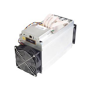

These devices, known as ASICs, made it unprofitable to continue mining with consumer-grade technology, quickly monopolizing the market and making it practically impossible for hobbyist miners to get started out, due to the high start-up costs associated with ASICs.

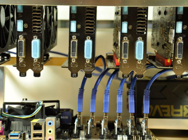

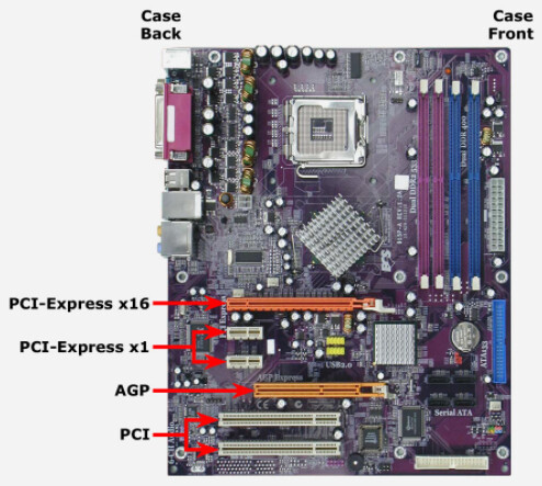

The issue with this is that, typically, computer motherboards only have 2-3 full sized PCI-E slots (This is the connector that your Graphics cards will plug in to) and they are often too close together to have multiple graphics cards side-by-side. In order to get around this, we are going to use PCI-E Risers (Extenders) that allow the graphics cards to the further away from the motherboard.
Not only does this result in better cooling, as the cards can be spaced appropriately, but it also allows you to utilize the smaller PCI-E slots, that graphics cards don’t normally fit in to. This means that you can fit up to six graphics cards on a normal motherboard. ASRock has actually designed a motherboard specifically for mining, which features 13 PCI-E Slots, and there are rumoured to be companies producing motherboards that can support 10s of cards.

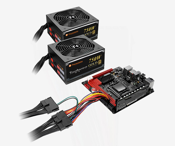

Another issue you can have with large builds is electricity. Each graphics card uses anywhere from 150-250 watts (Varies massively on the specific card) but the most cost-effective power supplies are around the 1000-1500w mark, meaning you may not be able to fit all of them on one power supply. Any easy workaround for this is to use a link-cable, allowing you to use two power supplies on one system.

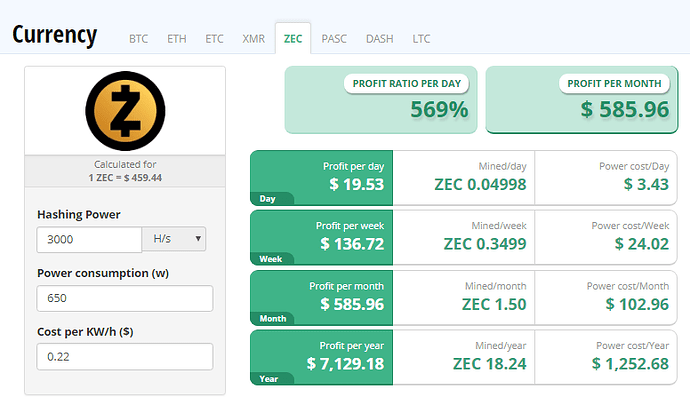

The trouble with calculating profit is that there are many variables at play that influence your earnings. There are many Mining Profitability Calculators online that offer an insight into how much you can expect to make. They work by calculating your potential daily/hourly earnings at that exact time and then using that figure to calculate weekly/monthly/yearly earnings.
This is unreliable information because you can’t predict any of the variables that affect this number. So then, what determines how much you earn? Before we go on, it’s important to actually understand this. Every coin has a network difficulty, which affects how many of your chosen coin you will receive for your mining. If the total network power of a coin were to suddenly change then the miners would be earning too much/ not enough of the coin. In order to prevent this, the mining difficulty increases/ decreases to reflect the network power resulting in a somewhat consistent total payout, in the currency.

Electricity Cost: Electricity cost is a massive factor in the mining industry, as GPUs draw a massive amount. If you’re not careful, and have a high electricity cost, it may not be worthwhile.
I use an Electricity Usage Monitor to accurately calculate my costs, however, the maths formula is very simple if you don’t want to buy one. Your electricity cost is KW/h usage * cost per unit * 24. For example, a rig that draws 1000Ws with an electricity cost of $0.18 per unit (Or KW/h) will cost 1240.18 or $4.32/day.

All three of these rigs are going to be six card set-ups, however, you can obviously expand that with the help of the ASRock H110 Pro BTC & a PSU Link cable. One important thing to note, when running a multi-PSU system, is that you should power all of the risers from the same power supply, to regulate the voltage. If you are using the H110 Pro, you should also make sure that your risers don’t short circuit by wrapping them in electrical tape.

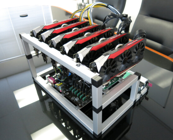

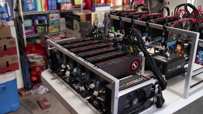

Now that you’ve selected your parts and are ready to go, it’s time to think about how you are going to build the actual system. While a normal computer case is fine if you are mining with 1-2 cards, a normal rig simply cannot fit inside one. There are thousands of frame designs out there (Even some pre-made ones that you can buy) however, the design is so simple it’s so much cheaper to just build it yourself.
I like to follow a design similar to the one above, using wood instead of metal. All the materials (Wood & screws) are easy to source and after looking at a few designs and watching some YouTube videos, you should be able to put the frame together in under an hour. The rest of the system is just like a regular computer, however, I recommend watching “How to Easily Build a 6x 1080 TI Mining Rig” if you’re unsure.

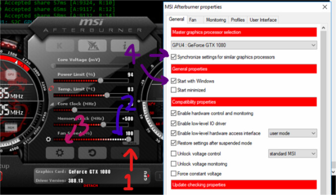

Install MSI Afterburner - By default, your GPU’s fans are set up to favour being quite over maximum cooling. When you’re maxing out your cards 24/7, it’s important to keep them below 70°C at all times (30-50 is ideal) if you plan on doing this long-term. MSI Afterburner allows you to change the fan speeds on your system, as well as overclock your cards (I don’t do this, but many people say it is worthwhile. Install it, then click the “Auto” button next to fan speed, so that it is dark grey. Now move the speed up to 95-100% and make sure this setting is set on all the cards by going to Settings > “Synchronize settings for similar graphics processors” and of course “Start with Windows.” Save the profile and you’re good to go.

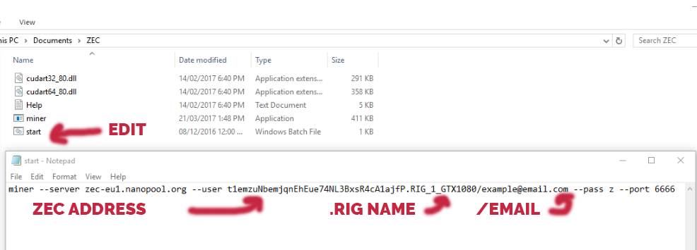

Let’s head over to NanoPool (You can pick any ZEC Pool out there) and download the miner that works best with your hardware (Do a bit of testing). Extract the .zip into a folder and then edit the start.bat file. (Right-Click > Edit)
Replace the Zcash address with yours (Get one here) as well as entering a name for your rig, if you want, and then adding your email. The rig name and email aren’t needed to get up-and-running but naming your system makes it easier to track performance when you have multiple systems & the email allows you to be notified when one system disconnects.
Save the file, and you’re done! you can now begin mining by clicking on start.bat! It’s that simple. If you would like to begin mining when Windows turns on, which is highly advisable, then you can add the start.bat file to your start-up files. (This guide explains it well) Simply create a shortcut to start.bat (Right Click > Create Shortcut) then press the Windows Key + R, type shell:startup and move the shortcut into the folder.
