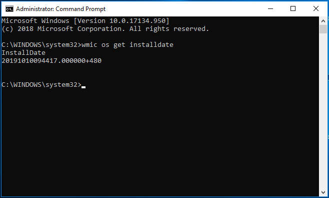

  1. Run Command Promptas an administrator in Windows 10/8/7.
  2. Use the command wmic os get installdate and press Enter . From the following screenshot, you should know the first six figures of numbers are the installation date – year, month, and day.
Tip: If you have reinstalled Windows previously, this way will be not available for you to check how old your computer is. From the screenshot, the date is October 10, 2019. Actually, my computer has been used for four years, and the time is not the first installation date.

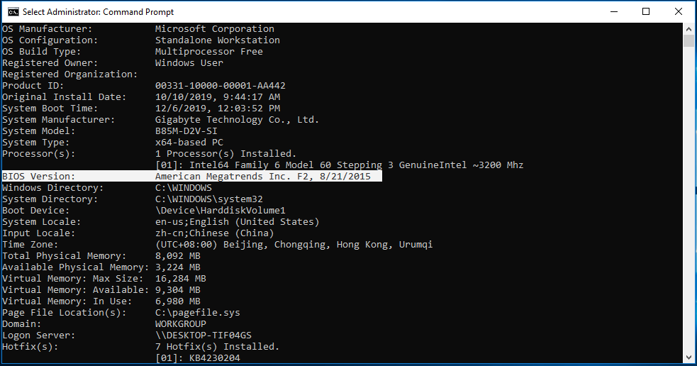

  1. Similarly, open Command Prompt with admin privileges.
  2. Input systeminfo to the new window and press Enter .
  3. Scroll down to find BIOS Version and you can find the date.
Note: If you updated your BIOS after purchasing the computer, you cannot get the accurate date. Besides, if you bought a second-hand computer, you cannot know if BIOS was updated by the previous owner.

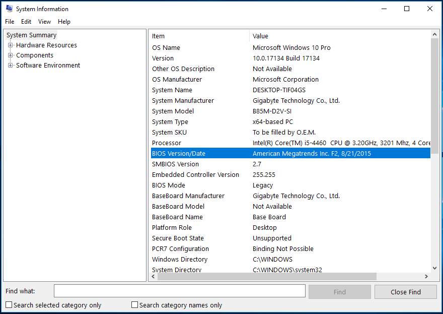

In my case, the information is “American Megatrends Inc. F2, 8/21/2015”. This is close to the date that I built my PC and helps me to know how old my computer is.

In addition to using systeminfo.exe, you can use the System Information tool to check the BIOS version. It is a pre-installed app on every computer.
Here is what to do:
  1. Open the Run dialog box.
  2. Type msinfo32.exe and press Enter to launch System Information.
  3. Find BIOS Version/Date to calculate how old your laptop or desktop is.
