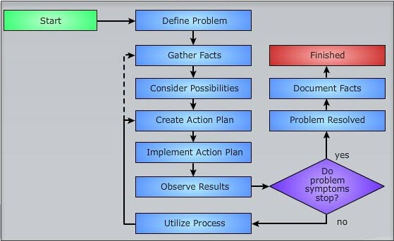

Network Troubleshooting Flowchart
Steps Involved In Network Diagnostics

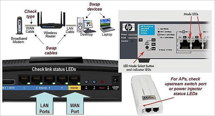

#1) Checking Cable connectivity Issue : The cables are used for connections, based on the type of connectivity. Like, for connectivity between a router and a computer the crossover pair of the cable is used. Thus make sure that the suggested and suitable cable is used to make a physical connection between any two devices .
If connections are found ok, then maybe the cable is faulty, so check the connectivity by replacing the existing cable with a newer one. Still, if the problem persists, then check the port or interface on which the link is terminated. There is a possibility for the port to be faulty.
#2) Port Faulty Scenario : Check that the port or interface on which the link is established is not shut down. Verify the duplex mode and speed as well. If the port is up and still the problem persists, then there are indicator lights that are present on each of the device to show the running status of the port.
From the indicator lights, check if the port is physically radiating or down. If the port is physically malfunctioning then it will appear by light status. In this situation, configure the link on some other free port or interface.
#3) Traffic overload : If there is more traffic than the carrying capacity at a link or interface then at some point it will start behaving abnormally. Thus verify these criteria to ensure smooth running.

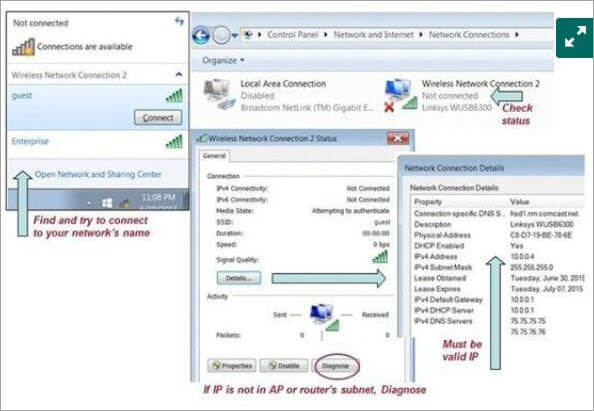

Troubleshooting Wireless Network Connection Issue

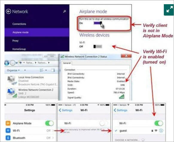

#1) Whenever you connect your Tablet, mobile phone or Laptop with the WI-FI device, and if you are not able to connect then check all the LAN or WAN cable connections.
The Ethernet cable should be connected tightly and check the light status on the device. If it is not green then the cable or port may be faulty. Thus change the port and cable connections with a newer one.
#2) After verification of all of the above points, if the connection is still not through, then verify the WI-FI network adaptor settings.
For windows laptop or PC, go to control panel, select the network connections option and check what is the status on the wireless network adaptor? It should be enabled. If it is not enabled then click on the enable key and mark the status as enabled.
Also, check if the airplane mode on a laptop or PC is disabled. If it is enabled, then it will not allow connecting with a wireless network.
Network Adaptor Settings
#3) After checking all the above settings, if the status is still not connected then check the wireless access point and SSID settings. After correction of the desired settings, the status will change from not connected to acquiring network address to connected. At this point, the client also allocates the IP address to the requesting device.
Network Connection Settings
#4) If still, the problem persists, then click on the diagnose option from the wireless network connection status menu to find out the cause.
#5) After performing all the above troubleshooting steps, if you are not able to connect to the network still, then there may be other reasons like some firewall or packet filter is barring you for using the network, and there could be a problem with the authentication protocol used etc.
#6) To resolve these issues, reconfigure all the network settings and verify the IP reachability by using PING.
