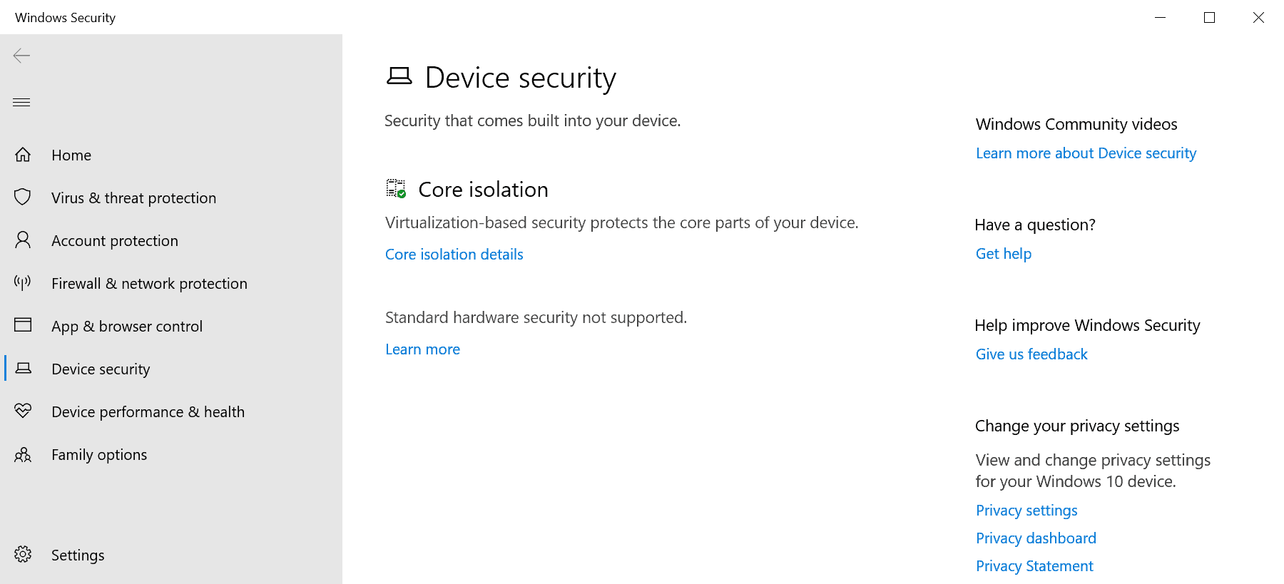

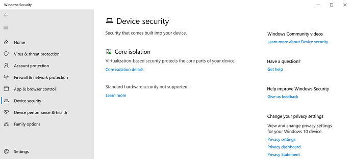

Windows users who run Windows 10, the only version of Windows with a direct upgrade path to Windows 11, may check TPM support in the following two ways:
  1. Open the Settings application, for instance by selecting Start > Settings, or with the keyboard shortcut Windows-I.
  2. Go to Update & Security > Windows Security > Device Security.
  3. TPM is not available if Security Processor is not displayed on the page that opens.
  4. TPM is available if Security Processor is displayed. In that case, select Security Processor to verify the specification version and find out if it is TPM 1.2 or TPM 2.0.

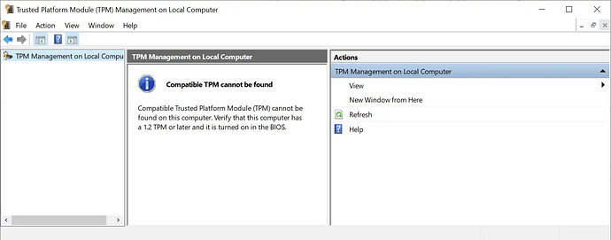

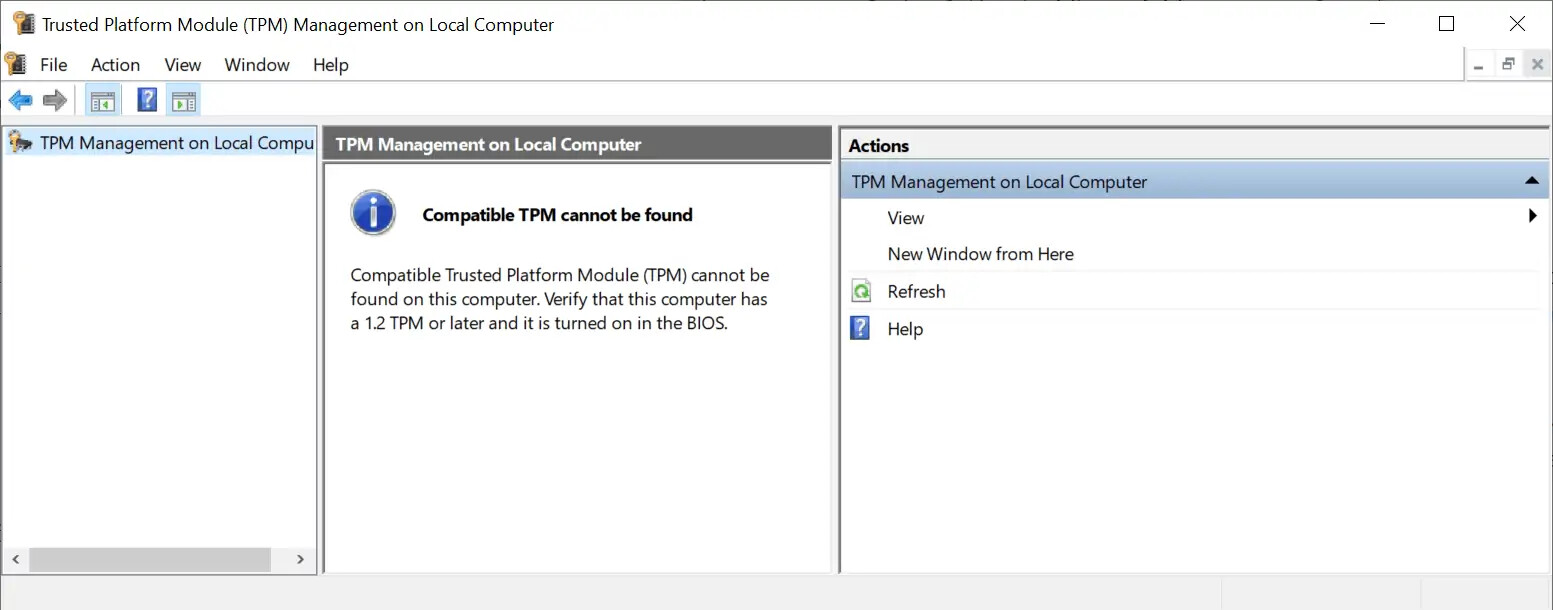

The second method uses the Microsoft Management Console:
  1. Use Windows-R to open the run box.
  2. Type tpm.msc.
  3. The window that opens reveals if TPM is supported or not, including the version if it is supported.
