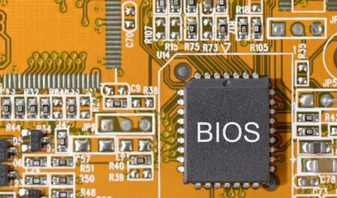

How to Increase VRAM in the BIOS
The BIOS is the basic firmware of your computer, letting all the hardware initialize and communicate so that it can hand over control to your operating system. So it makes sense that the settings which control the VRAM allocation of a dedicated GPU would be found here.
In modern systems you don’t get to specify a fixed amount of VRAM for your integrated GPU. Instead, you get to choose the maximum amount of RAM it may grab as it needs it. This is because your integrated GPU is now in competition with your CPU for memory resources and you don’t want the GPU hogging memory it doesn’t need right that minute!
As for the actual steps to change the value, every BIOS is different. First you’ll need to reboot your computer and then repeatedly press the BIOS shortcut button until it appears. That button also varies from one BIOS to the next, so look for an on-screen prompt or consult your motherboard manual.
Once you’re in the BIOS, you want to look for a page that contains settings for “integrated peripherals”, “VGA share” or something similar. The setting should be called something like “integrated graphics memory allocation” and show a value in MB or GB.
All you have to do is change that value to a higher one. Then save and exit from the BIOS. However, your particular BIOS may not have this option at all, leaving it completely automatic and out of your hands.
