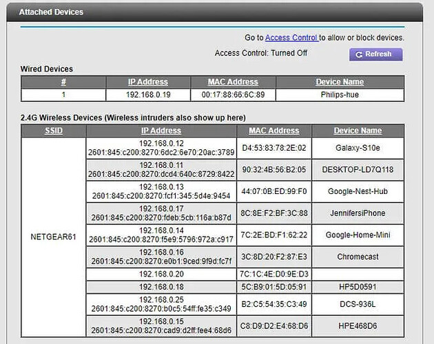

Your router then assigns IP addresses to individual devices inside the home network, on its own sub-network. These usually follow a standard convention, like 192.168.0.X. The X is assigned randomly, from 1 for the router itself, up to 255.

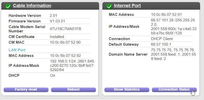

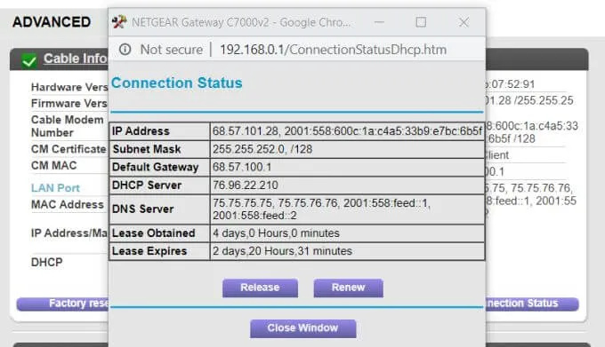

  1. Log into your router as an administrator, using the admin account and password.
  2. Every router has its own menu system. Find the area that shows the Internet connection status. For example in the Netgear router, select Advanced and then select Connection Status under Internet Port .
  1. This will open a window showing the current status of the router’s internet connection.

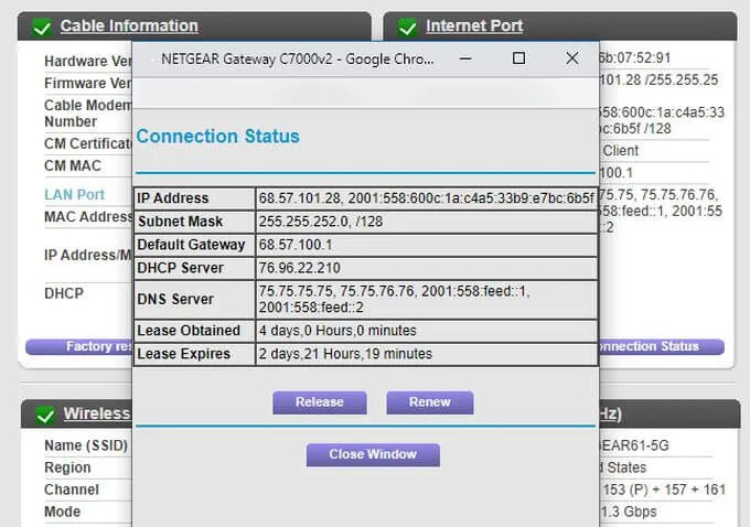

  1. At the bottom of this window you’ll see the Release and Renew buttons. First, select Release to release the router’s current IP address back to the ISP. At this point, the router will no longer have an active internet connection.
  2. Select the Renew button to obtain a new IP address for the router from the ISP. You’ll see a new IP Address appear in the window. Once you see this, it means your router is connected to the internet again.
In other router models, you may need to look in the WAN or Internet menus to find the internet connection status where you’ll see the Release and Renew buttons.
If you can’t find them, check the router’s manual or website for more information.

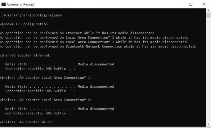

  1. Launch the command prompt.
  2. In the command prompt, type ipconfig/release .
  1. You’ll see a list of messages showing a disconnected status. This is normal and it means your network adapter has lost its connection to the network.

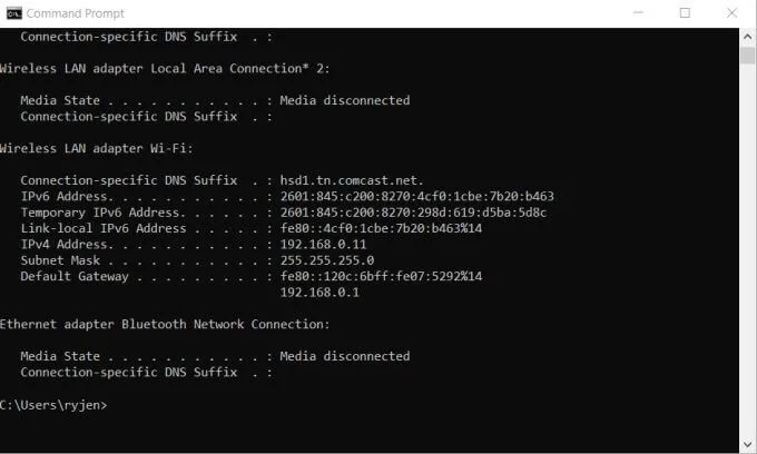

  2. Still in the command prompt, type ipconfig/renew .
This will cause your network adapter to reach out to the router and request a new IP address. The router will respond by assigning an IP address to your computer.
Scroll down to the bottom of the message and you should see that your network adapter now has a new IP address assigned to it.
Now that your computer has a new IP address, you can reconnect to the internet with your browser and browse the web as normal. If the internet isn’t working yet, you may need to restart your computer.

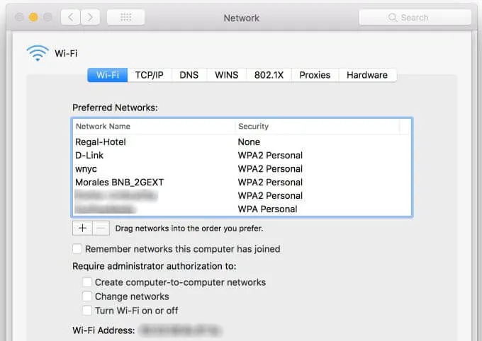

Release & Renew IP Address On Mac

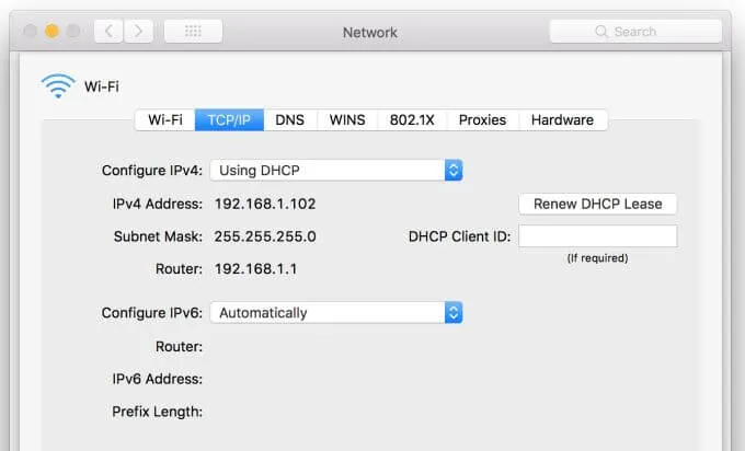

You can also release and renew your IP address on MacOS but instead of using the command prompt you can do this in the TCP/IP settings.
To do this:
  1. Select the Apple button and select System Preferences .
  2. Select the Network icon under Internet and Network .
  1. Select the TCP/IP tab in the Network window.
  2. On the right side of the window, you’ll see a Renew DHCP Lease button. Select it.
This will release and renew your IP address in one step. Select OK to exit the Network window. Exit the System Preferences window as well.
You may need to restart your Mac to finish the release and renew process.

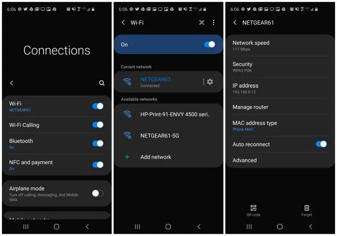

Getting a new IP address on your Android isn’t quite as straightforward. You need to force your phone to “forget” the current Wi-Fi network it’s connected to. Once you do this, it’ll release its current connection (and IP address). The next time you connect it’ll receive a new one.
To do this on Android:
  1. Go into your Android Settings screen.
  2. Tap Connections.
  3. Tap Wi-Fi.
  4. Select the Gear icon to the right of the Wi-Fi network with the Connected status.
  5. At the bottom of the screen, tap the Forget trash can icon.
This will drop the Wi-Fi connection with your router. When you reconnect by re-adding the Wi-Fi network and logging in with your Wi-Fi network login credentials, your Android will receive a new IP address.
