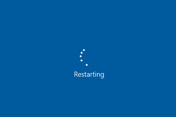

5. Random Reboot
Your PC keeps randomly restarting while you are performing a task. In addition, the computer just sometimes restarts. This symptom doesn’t always indicate a RAM problem. A hard drive problem can also cause a random reboot.
However, if your computer reboots almost immediately after the desktop initializes, this could be a bad RAM symptom.

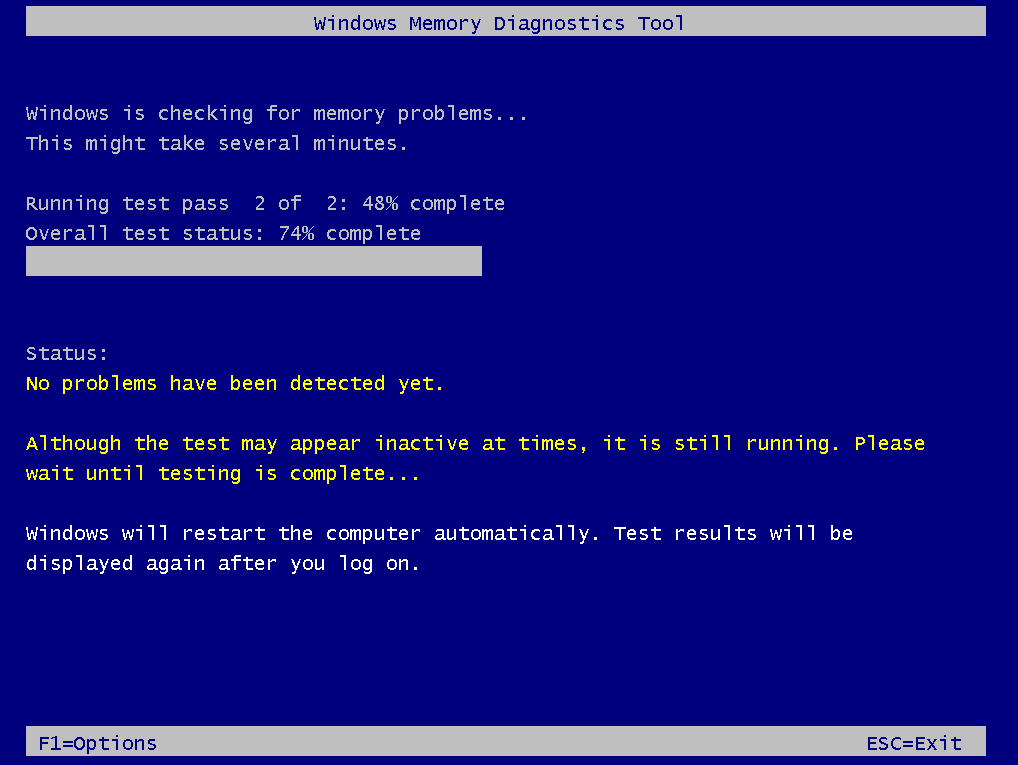

Windows Memory Diagnostics Tool
In Windows, there is a built-in tool called Windows Memory Diagnostics Tool. If you suspect a memory error, you can use it to have a check.
  1. To get it, you can go to Control Panel (viewed by large icons) and click Administrative Tools .
  2. Choose Windows Memory Diagnostic .
  3. In the new window, two options are offered. You can either restart now and check for problems or schedule the test to begin the next time you start up Windows.
  4. If you choose the first option, the tool will start diagnosing during the reboot process.
Note: You can press F1 to change the test option – Basic, Standard or Extended.
The process will take some time. After finishing the test, Windows will restart and test results will be reported to you after logging on to Windows. If some errors are found, Windows will give you a suggestion that you should do.
To see the check results, you can also do these steps via Event Viewer :
  1. Go to the search box, input eventvwr.exe and run this command.
  2. Expand Windows Logs , right-click System and click Find .
  3. Input MemoryDiagnostics-Results to find it.
  4. If you see at least one error, this means one of the RAM modules may have problems and you need to replace it.

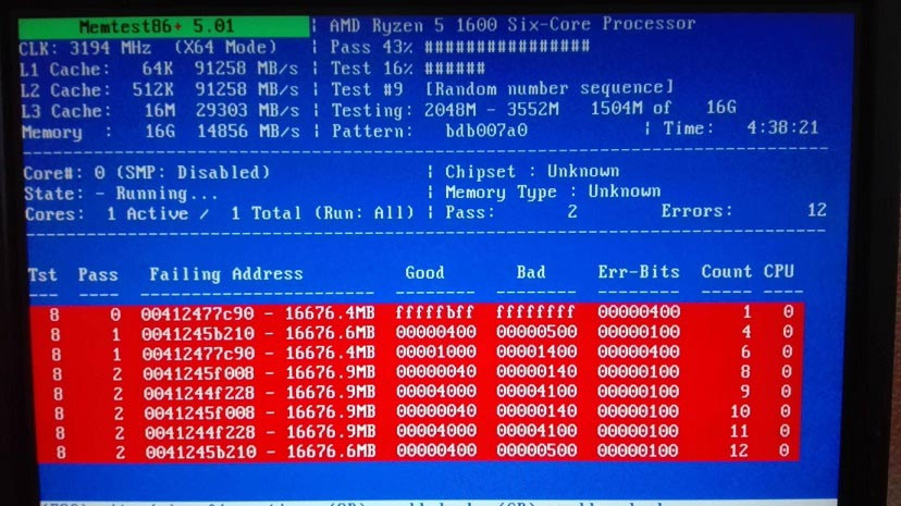

Memtest86
In addition, there is a very popular RAM test diagnostic tool – Memtest86. It is used by many users all over the world and always works well.
How to check if RAM is working or not?
To use it, you need to download it from its official website. You can burn it to a CD disc or USB flash drive and configure the computer to boot from the device. Then, you can use it to do a deep test.
If this tool finds some RAM errors, it will show you the result in red. If errors appear at the same or nearby addresses, it’s likely that the RAM stick is defective. You need to replace your faulty RAM.
