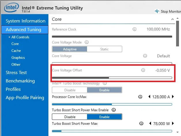

There are two popular utilities that avid undervolters use to wean their CPUs off the juice. If you’re using an Intel CPU, then the Intel Extreme Tuning Utility (XTU) is a good choice. No one knows Intel’s CPUs better than Intel, after all.
Sadly, the program isn’t the most user-friendly in the world and it has a heap of settings and sections that can be confusing if you aren’t familiar with all the CPU jargon. Luckily for undervolting we only have to care about a small number of settings. In XTU these are all under the “core” section of the app. What matters is “core offset voltage”.
Modern CPUs, especially those in laptops, don’t use a static voltage. Instead, the voltage is adjusted as per the amount of load in the CPU. This is one of the reasons undervolting doesn’t get quite the results it used to, since the CPU is actually undervolting itself when idle. By adjusting the voltage offset, we change the minimum and maximum voltage range the CPU will use.
NOTE: If you see that Core Offset Voltage is greyed out, this is possibly due to a security patch that some OEM (Original Equipment Manufacturer) have implemented. This mainly affects laptops, but can also be true of certain prebuilt desktop systems.
This is thanks to a hacking exploit known as Plundervolt. The only way to get the function back would be to flash an older unpatched version of the BIOS, if available. We don’t recommend you do this unless you know exactly what you’re doing.

  1. Before changing anything, run your CPU benchmark of choice and write down the score. Make a note of the peak temperature of your CPU. CPU-Z is a great program for that purpose.
  2. Reduce the voltage offset by 5mv. If you’re feeling brave you can get a headstart with a 50mv reduction, from there 5-10mv is the most sensible increment.
  3. After the reduction, run a stress test such as Prime95 or the built in stress test in XTU.
  4. Assuming the stress test passes, run your benchmark again. Performance should be the same or better.
  5. Repeat the process.
If your CPU becomes unstable or your performance starts to get worse compared to the previous benchmark, dial your voltage back to the last successful attempt and use that as your go-to setting.
