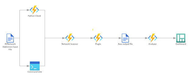

Architecture
Adding Plugins
When developing locally make sure to mark src folder as âSources rootâ
- Create new directory under plugins folder with your plugin name
- Create new Python file with your plugin name
- Use the following template to write your plugin and replace âGeneralâ with your plugin name
from pathlib import Path from forensic.interfaces.plugin import PluginInterface, PluginConfig, PluginCLI from forensic.common.constants.constants import Transport class GeneralCLI(PluginCLI): def init(self, folder_name): super().init(folder_name) self.name = âGeneralâ self.description = âGeneral Plugin Descriptionâ self.port = 123 self.transport = Transport.TCP def flags(self, parser): self.base_flags(parser, self.port, self.transport) parser.add_argument(ââgeneralâ, help=âGeneral additional argumentâ, metavar=ââ) class General(PluginInterface): def init(self, config: PluginConfig, output_dir: Path, verbose: bool): super().init(config, output_dir, verbose) def connect(self, address): self.logger.info(f"{self.config.name} connect") def export(self, extracted): self.logger.info(f"{self.config.name} export")
- Make sure to import your new plugin in the
__init__.pyfile under the plugins folder - In the PluginInterface inherited class there is âconfigâ parameters, you can use this to access any data thatâs available in the PluginConfig object (plugin name, addresses, port, transport, parameters).
there are 2 mandatory functions (connect, export).
the connect function receives single ip address and extracts any relevant information from the device and return it.
the export function receives the information that was extracted from all the devices and there you can export it to file. - In the PluginCLI inherited class you need to specify in the init function the default information related to this plugin.
there is a single mandatory function (flags).
In which you must call base_flags, and you can add any additional flags that you want to have.
Adding Analyzers
- Create new directory under analyzers folder with the plugin name that related to your analyzer.
- Create new Python file with your analyzer name
from pathlib import Path from forensic.interfaces.analyzer import AnalyzerInterface, AnalyzerConfig class General(AnalyzerInterface): def init(self, config: AnalyzerConfig, output_dir: Path, verbose: bool): super().init(config, output_dir, verbose) self.plugin_name = âGeneralâ self.create_output_dir(self.plugin_name) def analyze(self): pass
- Make sure to import your new analyzer in the
__init__.pyfile under the analyzers folder
