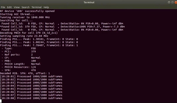

General downlink sniffing
LTESniffer Downlink Mode
sudo .//src/LTESniffer -A 2 -W -f
-C -m 0 example: sudo ./src/LTESniffer -A 2 -W 4 -f 1840e6 -C -m 0 -A: number of antennas -W: number of threads -f: downlink frequency -C: turn on cell search -m: sniffer mode, 0 for downlink sniffing and 1 for uplink sniffing

        The information displayed on the terminal
        Downlink Sniffing Mode
        Processed 1000/1000 subframes: Number of subframes was processed by LTESniffer last 1 second. There are 1000 LTE subframes per second by design.
        RNTI: Radio Network Temporary Identifier of UEs.
        Table: The maximum modulation scheme that is used by smartphones in downlink. LTESniffer supports up to 256QAM in the downlink. Refer to our paper for more details.
        Active: Number of detected messages of RNTIs.
        Success: Number of successfully decoded messages over number of detected messages (Active).
        New TX, ReTX, HARQ, Normal: Statistic of new messages and retransmitted messages. This function is in development.
        W_MIMO, W_pinfor, Other: Number of messages with wrong radio configuration, only for debugging.
