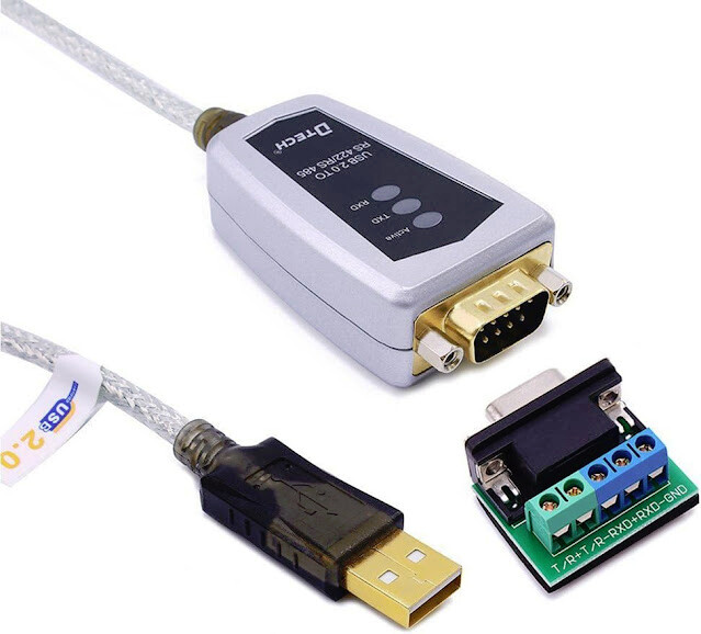

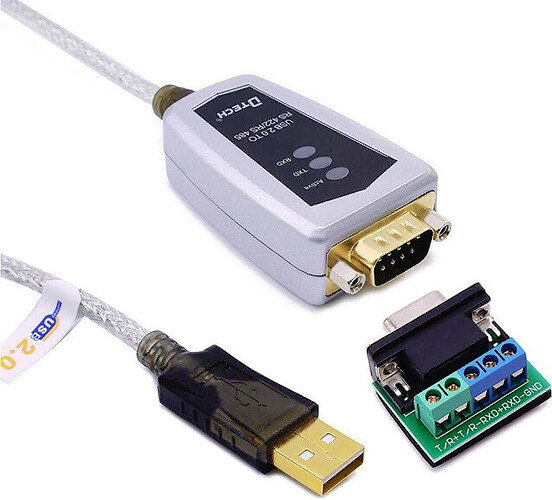

You’ll find proof-of-concept code for each of these attacks in attack_osdp.py. Checkout the --help command for more details on usage. This is a Python script, meant to be run from a laptop with USB<–>RS485 adapters like one of these. So you’ll probably want to pick some of those up. Doesn’t have to be that model, though.
If you have a controller you want to test, then great. Use that. If you don’t, then we have an intentionally-vulnerable OSDP controller that you can use here: vulnserver.py.
Some of the attacks in attack_osdp.py will expect to be as a full MitM between a functioning reader and controller. To test these, you might need three USB<–>RS485 adapters, hooked together with a breadboard.
