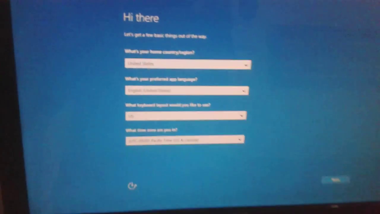

My PC was running slow so is backed up all data on ext hdd and hard reset my pc, but after the reset completed, my mouse and keyboard are not working when first window opens up (Hi there…) But if i open bios on restarting they seem to work fine.

Sir, i cant open my pc, i have erased every thing and now mouse and k.b. are not working when the new windows starts and asks for details like, what is my country, language etc.

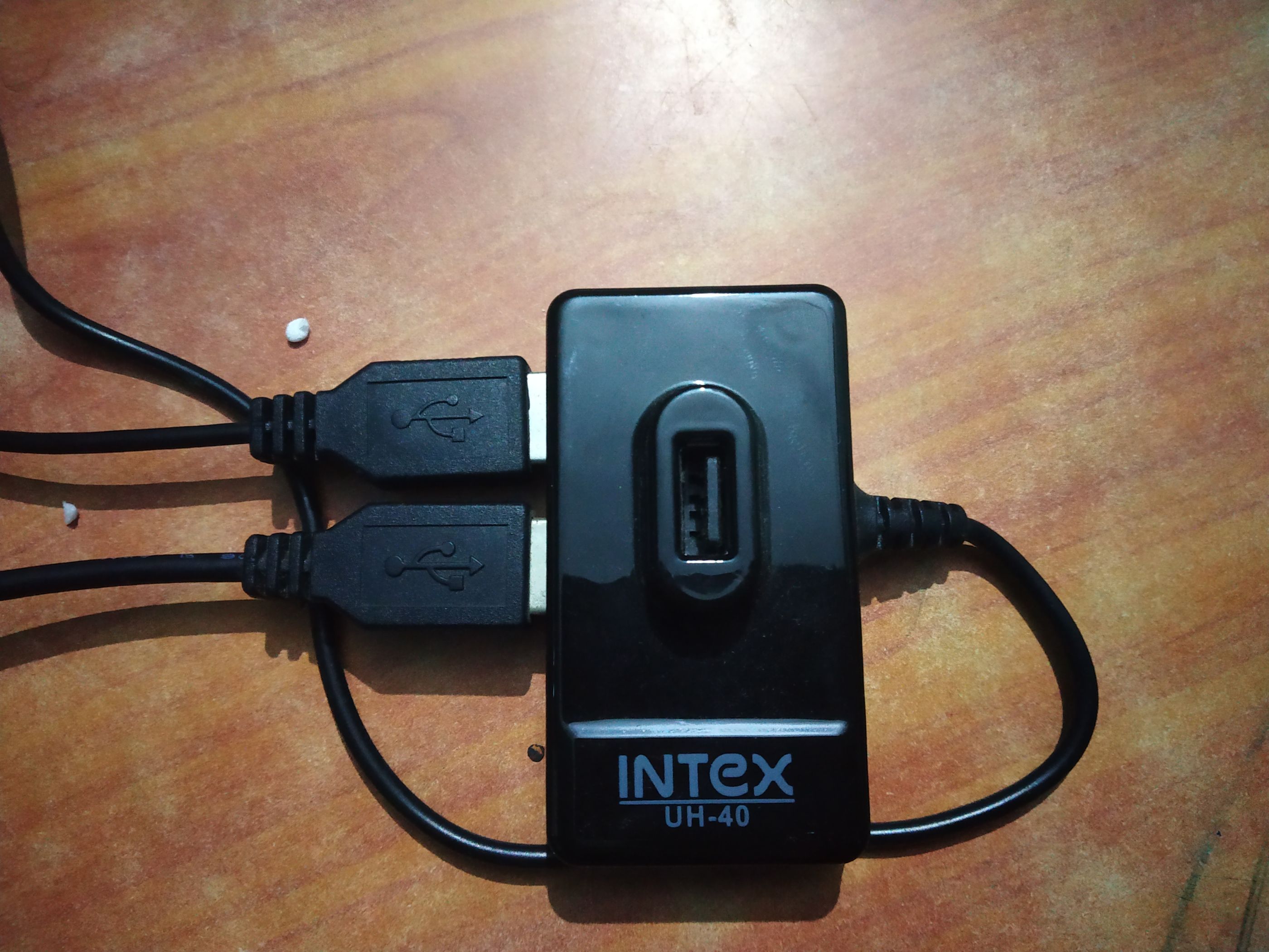

Thanks, everyone for their immediate support, I tried all the methods u guys wrote, sadly didn’t work.
But then, this reply clicked something in my mind,
And F*ck yeah, this baby saved my PC (Got it from a friend)-
Once again Thanks to everyone who gave me instant help, really this site is a MIRACLE.
