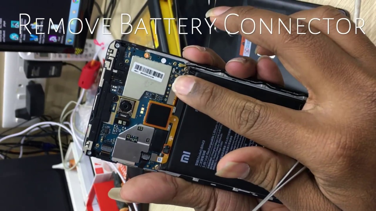

You must do as follow
Go to EDM mode
by opening back panel and shorting the pins to enter into EDM mode
use mi tool
and proceed with the stock os
let it restart in normal mode

I tried flashing official rom using miflash tool. It also shown as success. But still, same problem exists!! :pensive:
Its the battery problem, nothing was wrong with software. After changing the battery everything works fine.
Thanks to all for your valuable advises..!!!
What’s the problem with battery?
Did u replace with new battery or just recharged existing battery?
I think the battery’s life is over,
It took long time (8+ hrs) to get fully charged
It was not capable of booting up the device to the system.(which caused boot-loop, i think)
P.S: I changed to a new battery.!!
