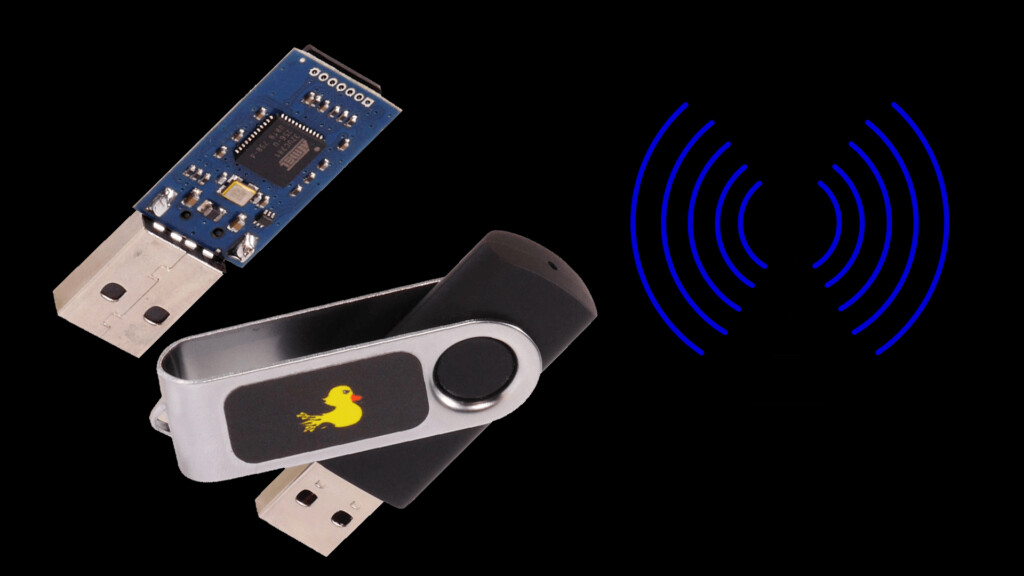

UberDucky | (Wireless USB Rubber Ducky) Tool For Injecting Keystoke Into Computer Via Wireless
Uberducky is a tool for injecting keystrokes into a target computer that can be triggered wirelessly via BLE. It is inspired by Hak5’s USB Rubber Ducky, and like that tool it impersonates a USB keyboard and can inject malicious payloads such as reverse shells and RATs.
A normal USB Rubber Ducky has one major shortcoming: it is only useful when the target machine is left unlocked. An Uberducky can be hidden in a forgotten USB port, such as behind a tower under a desk or attached to a monitor. As soon as the operator of the target system drops their guard (or you distract them), Uberducky can be triggered to drop a malicious payload.
