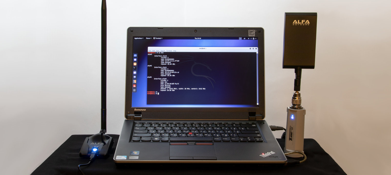

What equipment is required to audit wireless networks?
In fact, you don’t need a lot: a Linux laptop and a USB Wi-Fi adapter. In theory, you can try using a smartphone as well, but some attacks require two USB ports. As a last resort, a laptop without a hard drive and, accordingly, with no OS installed would suffice, too.
