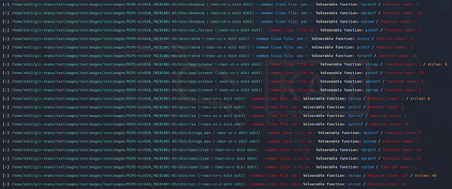

Static firmware testing:
  • Extract the firmware from an update file or from flash storage with binwalk or something else
  • Execute emba with set parameters, e.g.
sudo ./emba.sh -l ./logs/arm_test -f ./firmware/arm_firmware/
emba example startup
