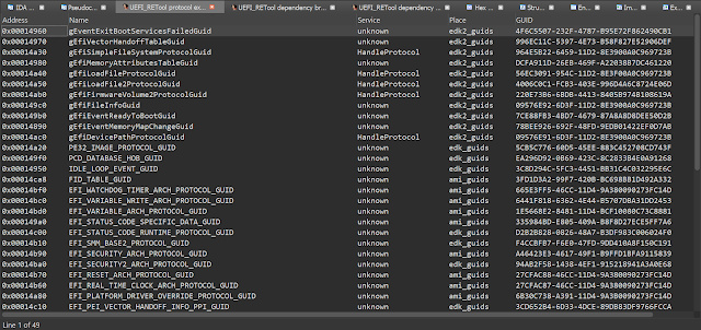

Analyser & Protocol explorer
Usage
  • Copy uefi_analyser and uefi_analyser.py to your %IDA_DIR%/plugins directory
  • Open the executable UEFI image in IDA and go to Edit → Plugins → UEFI analyser (alternatively, you can use the key combination Ctrl+Alt+U )

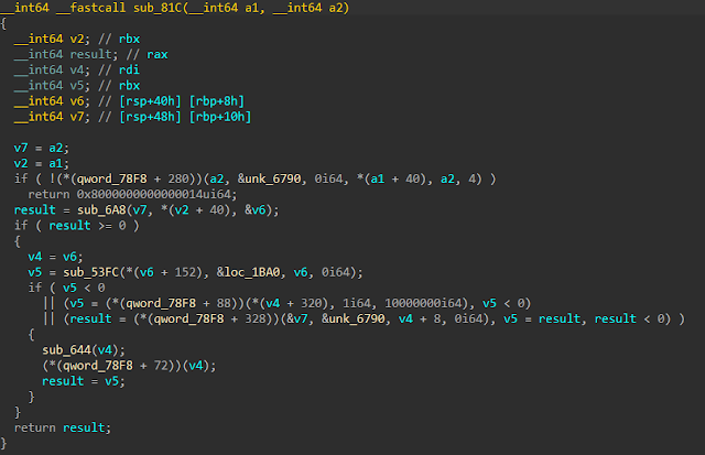

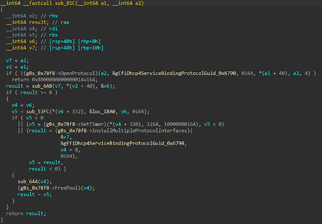

Example
Before analysis
After analysis
Protocol explorer window

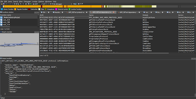

Dependency browser & Dependency graph

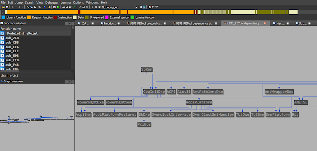

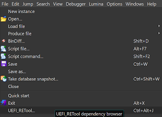

Usage
python uefi_retool.py get-info FIRMWARE_PATH
  • Load <LOGS_DIR>/<FIRMWARE_NAME>-all-info.json file to IDA ( File → UEFI_RETool... )
  • alternatively, you can use the key combination Ctrl+Alt+J )
Example
Dependency browser window
Dependency graph
