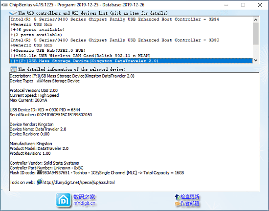

ChipGenius is a simple Windows program that helps you extract certain details from USB devices. This information covers the version and/or the serial number of the hardware that can potentially help you fix the problem. This is a portable software that you can download from the website mentioned at the end of this article. The website is mostly in Russian but that won’t be a problem with the URL auto-translation feature of the web browser.
The list catalogs almost all the releases of the program so far starting with the initial build. Scroll down to the webpage and download the latest version. You get a 7zip file which is password protected. The password for the file is mentioned alongside the program version.
When you run this program, it lists all the devices connected to PC along with ports and controllers. You can tap on an item to get information about it. It doesn’t show you any information for the ports which is obvious. But it shows various types of detailed for controllers and hardware devices. The same goes with USB Drive. Even if the USB drive is not shown in Windows Explorer. As long as you can see the device in Device Manager, this tool can get you information on that. You can note down the device vendor, version, and serial from there and find the driver manually to fix the problem.
