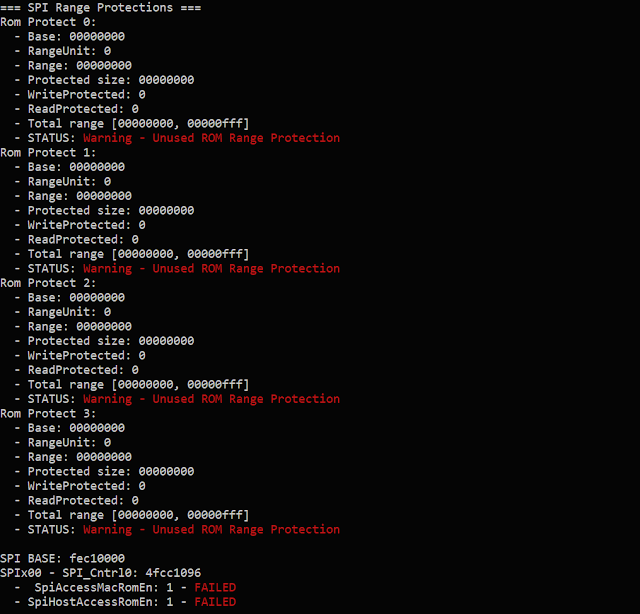

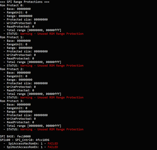

Example of ‘chipset’ command output for an AMD platform
