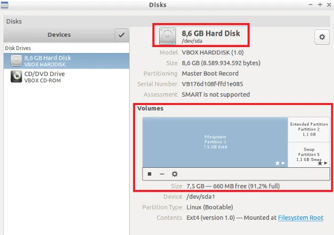

How To Free Up Hard Drive Space
  • To find out how much free space you have on your hard drive, click the Start Button, then Accessories , and then Disks .
Ubuntu doesn’t have the same disk clean-up tools and built-in defrag like Windows. So, what can you do to free up some disk space?

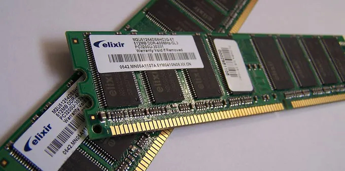

If you are running Ubuntu and your system randomly crashes, you may be running out of memory. Low memory could be caused by opening more applications or data files than will fit in the memory you have installed.
If that is the problem, do not open so much at one time or upgrade to more memory on your computer.
Another cause of low memory is a failing RAM. Run a memory test to determine whether your RAM memory is bad.

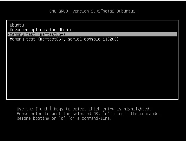

How To Perform a Memory Test

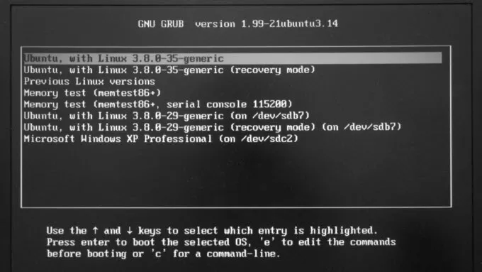

  • Start by turning on or restarting your system.
  • Bring up the GRUB menu by holding down Shift on your keyboard.
  • Using the arrow keys, find the Ubuntu memtest86+ label.
  • After you press the enter key, the memory test will automatically run. You will see a blue screen while the test is running.
  • The test won’t end until you press the escape key. Let the test run for at least one full pass. If your problem is very intermittent, let the test run much longer.
Should the test find any errors, you need to replace one of your RAM memory cards.
