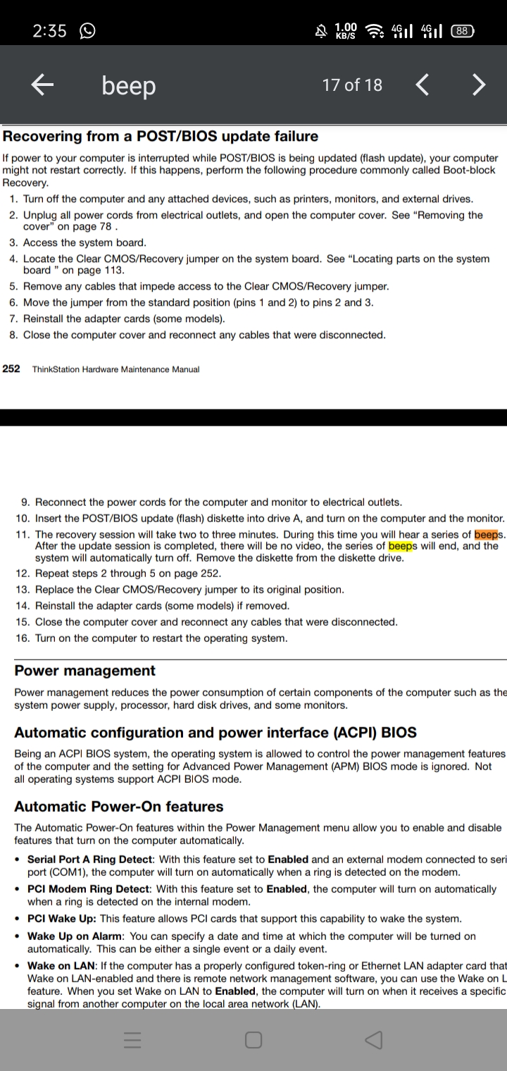

I’ve read THE MANUAL FOR MY PC and I think that I found what I was looking for but can you tell me these 2 things.
1: what are CMOS/RECOVERY JUMPERS are and where are they located?
2: what is POST/BIOS (flash) Diskette and how can I get it?
