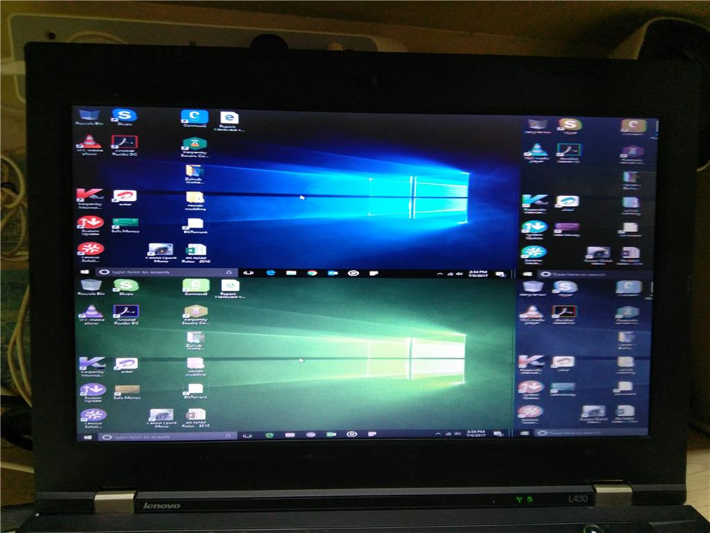

my windows 10 screen split two sides at the time of opening or booting.the left side is little dark and right side is little white.what is this .how can i rid of them?..

If your screen looks like this, than you need to take your laptop to the service center, so that they can run their display and other system diagnosis tools!
