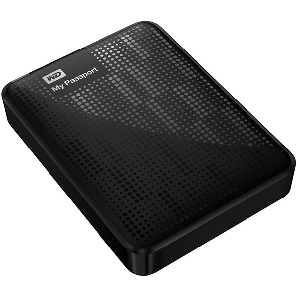

WD My Passport External Drive (2TB) shows 0B partition
Hello everybody, I am seeking for assistance please anybody who can help me fix my external Passport? I tried buying a new USB 3.0 it did not work. Any better suggestions? I tried a lot of things which never helped.

Mayur_Sinalkar the disk fails to create new partition it says Insufficient disk storage when i try making new partition. It also indicates no media on disk management, also displays on the tray and not on my computer.
What is the exact model of the external drive?
I Don’t know the model but it looks like that. I have been using this for so many years but now it can’t show anything.

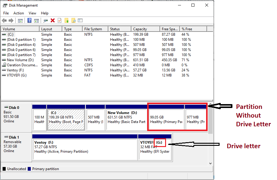

First do some necessary checks of hard disk - (Following are the steps)
  1. Connect the Hard Disk to PC.
  2. Open the run Dialog Box by pressing Windows + R key.
  3. Type diskmgmt.msc and hit Enter.
  4. Disk Management Window will appear, check whether your Hard Disk is visible in that Window or not. If Visible, Check its size and partition color. Also check whether any drive letter (D: E: etc) is provided to your Hard Disk Partition or not.
  5. If your hard disk with actual size is not visible than there may be some hardware issue in your hard disk.
  6. If The Drive is visible and its Color is Black instead of Blue it means the partition is unallocated, you have to allocate it first before use :
    Right click on the Black Partition and choose “New Simple Volume” and follow the instructions.
  7. If the drive color is Blue but Drive letter is missing than you have to add it :
    Right Click of the partition and choose “Change Drive Letter and Paths” and add a drive letter to the partition.
Note : Sometime some partitions are not visible in PCs. So in that case you have to format the drive with NTFS or exFAT
In most of the cases the drive will recover with above process. If not, than try formatting your drivve using Command Prompt
